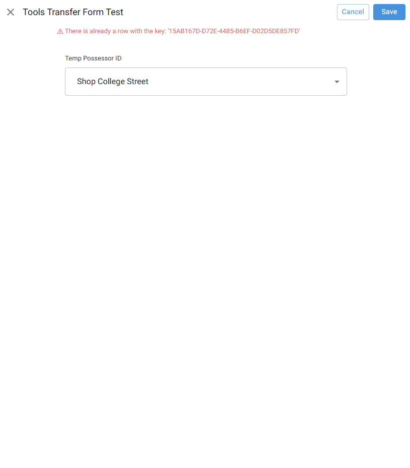

Getting an error of There is already a row with the key: ' ' with UNIQUEID() set in keys
I have a simple Tools inventory app. The error occurs when I try to transfer a tool to from one person to another person with an action button. If i do it without the action button, i do not get an error and it works fine. I'm not sure what information is needed so I will screenshot my tables & the action set up. Please let me know what other information I need to give.

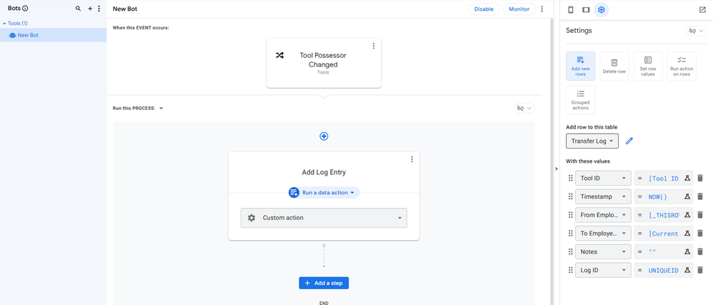

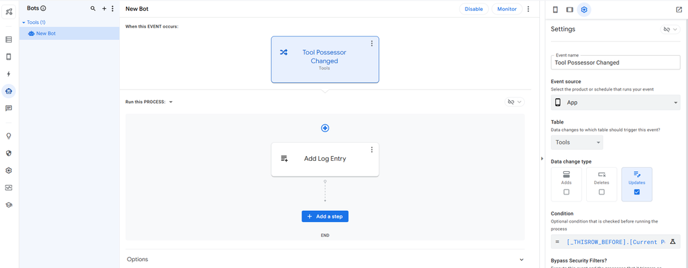

Picture of the error receivedPicture of the error receivedThe action button set upThe action button set upBot trigger conditionBot trigger conditionStep/Process actionStep/Process action

Your automation ("New Bot" triggered by "Tool Possessor Changed") seems correctly configured!
  • Event: It triggers on Updates to the Tools table when the Current Owner changes ([_THISROW_BEFORE].[Current Owner] <> [Current Owner]). This is perfect.
  • Action: It correctly adds a new row to the Transfer Log table, capturing the Tool ID, the timestamp (NOW()), the previous owner ([_THISROW_BEFORE].[Current Owner]), the new owner ([Current Owner]), and generating a unique Log ID (UNIQUEID()) for the log entry itself.
This automation should work perfectly fine once the main Edit action is corrected as described above.

here is a Screen Shot repro of the error.
I can add Screen Shots of how the actions are set up if needed, and This particular tool was added before i made the change to the UniqueID initial value which is why it has the UUID, not the TIMESTAMP attached to this tool.
