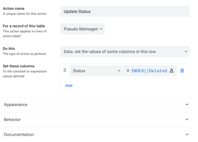

Got it. In that case, I would follow the same guidance from @Suvrutt_Gurjar but add the expression in an Action and then I would enable an automation that triggers that action. Here's how I got it to work. I think these patterns are best solved via automation.
Objective: Bring a value from a child row to the parent row. Assume only one child row per parent
1. Create action in the parent table (mine is called Pseudo Memegen): Set the value of a column. Select the Status column, include the INDEX() expression
2. Create automation. You set the rules of when it triggers, it may be when any change happens in the Child table (mine is called Comments).  Select the RUN ACTION ON ROWS option. You want to find a set of rows (only one in this case) and then execute an action. To identify Row you want to change, make a list of one by bringing up the column that has the parent value (the column with the REF in the Child table) in my case is called Meme. Then select the action that you created in step 1.
3. If everything is set up correctly and the app is published, you should have an action that updates the parent with a value from the child table. Again, this works on a 1:1 relationship, if you have many child rows for one parent, you need to change the strategy on how to select the row value to update. But the strategy with automation would be the same.
