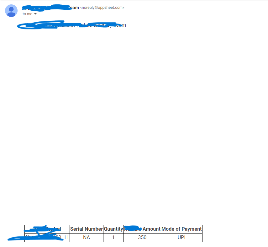

Hi Everyone,
I am trying to get email of related values in a Table format through HTML Code in the Email Body (Bots -> Events -> Run this process). I'm encountering an issue with Gmail's rendering of my email templates, when using HTML Code. When I send out emails, I'm consistently noticing a significant amount of space before the table containing the content. Iโ€™m at a loss for why this is happening and how to fix it.
Has anyone else encountered a similar issue with Gmail's rendering? If so, could you please share any insights or solutions that might help me resolve this spacing problem? I'd greatly appreciate your input and expertise.
Thank you in advance for your help!
And here is the HTML Code, that is present in the Email Body

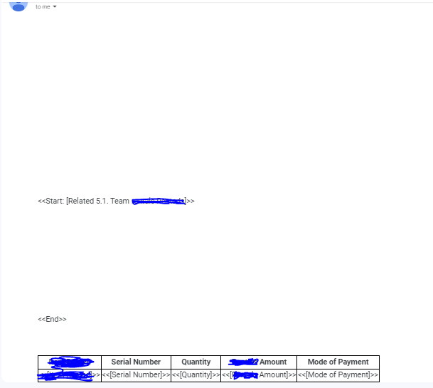

Somehow, it is getting like this when I previewed the Email and even in the real email, when I inserted the above code @SkrOYC
Show us the real one, the email generated, not the preview. I find the preview stuff quite useless.
Also post a screenshot/s of the Task config
 Appsheet HTML Issue 1.PNGAppsheet HTML Issue 2.PNGAppsheet HTML Issue 3.PNGThis is how I am getting the real email. Moreover, earlier I used to get related column values in the table
