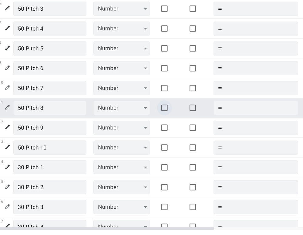

I have tried a virtual column with the above expression to gain a "score" from the user input - then another virtual column to SUM the "scores" (there are 10 scores per distance).
However this does mean there will be 60 real columns then 60 virtual columns.
You may want to elaborate this statement. A screenshot of table columns will help. It is not clear why so many real / virtual columns will be required.
If there is one distance in one record, only one column should to to compute the score for it?
https://support.google.com/area120-tables/answer/9902873?hl=en&sjid=3327532115003784057-AP
https://support.google.com/appsheet/answer/10106698?hl=en&sjid=3327532115003784057-AP
Hopefully this explains why so many columns...
Golfers get 10 shots for each of the 6 distances, therefore 6 scores to add to create total score for each distance.

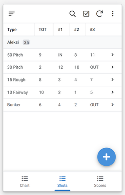

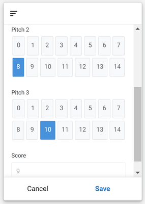

With Enum/Ref column, the result would be something like this.. and the Score is calculated exactly like [Pitch 1]+[Pitch 2]+[Pitch 3], no virtual or other columns are needed. In this sample, the Pitch 1 = "Ball in" and these numbers are distances (feet) from the flag.

If the accuracy is one feet, and it's enough, you would not need more than these.. or maybe you could use "Ball in hole" and "Too far away".
Meaning.. you would need to have 60 of these Enum columns + 6 normal columns where those 6 sets are counted.
You could have 6x10 columns like this.. and they are all reading values from one Score table.

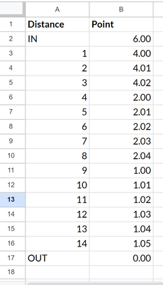

The magic is happening in that Score table. It has two columns, Distance and Point. The Point is the key column and Distance is the label. Because the key column needs to be unique, you can't have the same points for multiple rows, and that's why you need to use decimal values that are close to your real values. When you sum them with the number column (Score), those decimals doesn't matter.. If you would need to count all these 60 pitches together, then you need to use 1.0001 instead of 1.01 etc.

If you would build the app with 10+1 columns, it would be easier for coaches to handle the data with the mobile device. You could then build a view like this and the app user would not need to scroll 60+6 columns left and right.
What I have used with other score apps, I have splitted the tests to 6 different rows. Then you would only need 10 + 1 normal columns in your table, not 60 + 6. Then each players would have 6 different tests from 6 different distances.

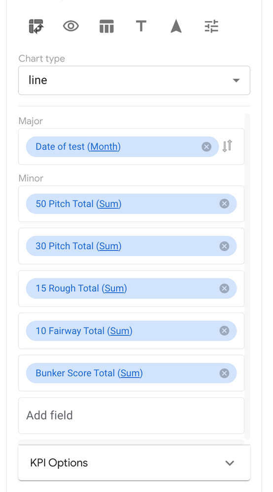

Little update. I've gone ahead with creating a VC for each shot (60) plus 6 more to SUM those totals to then use to create a graph.
Seems to work fine and the users are happy. I understand it's probably not as streamline as it could be.
What I'm thinking here.. create an another table with two columns.. Score (key) and distance (label).
Set the scores like 1.001, 1.002, 1.003, 2.001, 2.002 etc. for different feets. Then you can show the feet for the user with the Enum column base of Ref, but the score is saved to your data source. Then you don't need to use any virtual columns.. and those 6 summary columns can be normal columns as well.
