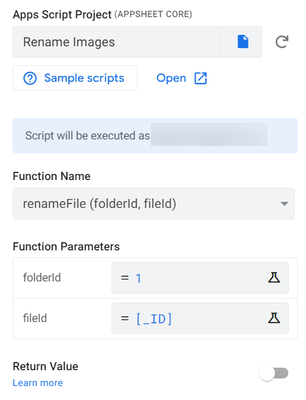

I do have the hardcoded in my script. I created an object that points to a few different folders that the script maintains and the bot task references by a number. I do it for security purposes. I may look at passing the folder path as an alternative and see if that makes a difference. I will let you know. Thanks!
folderID = 1, as shown in your image, is assigning the value of "1".  I don't think that is what you intended.
And that is not what I mean by "hard coded".
Place the actual ID values into the fields as arguments - no expressions or columns - to verify it works at all.  Once you are convinced it does indeed work, then use a sophisticated implementation that suits your needs.
Otherwise, you could spend hours trying to figure out why things in your implementation are not working only to realize that the function is not supported or works in a way you didn't understand.
This might help. The first image here is on my folderModel object. It has a class I created to obfuscate passing my personal Google Drive Folder IDs through the app. I use an integer that the app is aware of in replacement.
This is the function called to rename the file in the GoogleDrive script. Nothing abnormally done here.
I hope that makes more sense on what I was doing initially and I always intended to pass the integer for a folder id. Now as I attempt to try a different approach with the folder path, I will let you know if I have better success finding the file based on content from it like the file name. Hope this helps clear the confusion. 🙂
