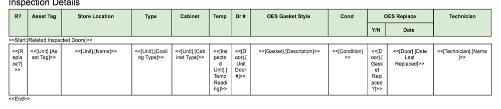

Where it is really strange is when I create a single row table used for repeating rows such as with a SELECT() or REF_ROWS() list inside of the template. The columns in the output are of different widths from one row to the next even thought the data is of comparable widths.
Is there something I need to do to force constant columns widths in the table?
Here is my template table:
And this is the resulting output
Try putting the start expression in the first cell of the row, instead of before the row, and the END in the last cell.

Yes that worked!! I was skeptical it would. Interesting!
I liked the placement of the Start/End outside the table because it is somewhat easier to read. It worked that way for me before because I was using multi-line tables. So I didn’t have an issue (or at least see one) with mis-aligned columns.

Great! It appears that your start-expression table is separate from your header table, yah? In that case, what the Start expression is doing (I think), is creating a whole new HTML table with each iteration, which means that each row is separate, and so nothing is binding the columns widths together to be the same. Moving it inside the table makes it so each iteration just makes a new row in the table.
