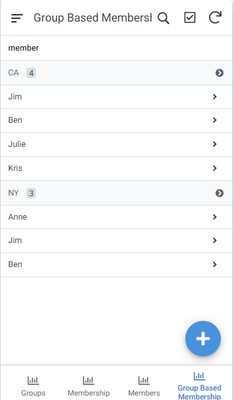

I think the 'easiest' way is to create a Membership table with two cols - member and group (and a VC of the two cols concatenated to act as the key to avoid any duplicates )
then you can create a view like this

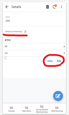

you can also maintain membership from you member view
