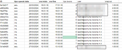

the record sheet called TESTDATA
The operator table called UTENTI, at every operator is assigned the operator type
the activity type sheet called TIPILAV, where the activity tipe is coded, and associated to a operator type

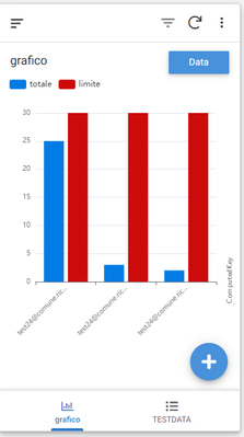

This is my best result

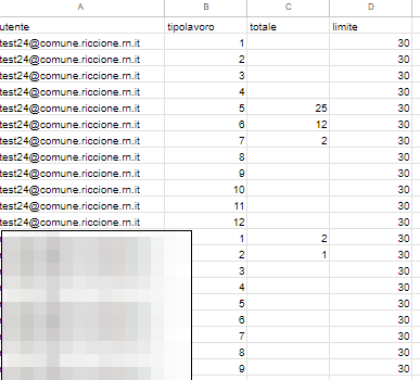

reached after hard coding a sheet called PIVOT to summarize every activity type for any operator, in future i  could update this table using google app script, but as there are about 100 operators and 30 activity type it will be a heavy sheet.
The tag in the bar is the operator email, I'd like it to be the actyvity type name.

Found solution for question number one,
The PIVOT table manually filled to test the graph now is filled by query and filter formula!
=QUERY(TESTDATA!A:H,"select G,F, SUM(H) WHERE G<>'' group by G,F")
This query sum hours grouping by user and activity type and give me the subtotals i need for chart.

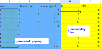

=FILTER({PIVOT!B2:B,VLOOKUP(PIVOT!B2:B, {TIPILAV!A2:A,TIPILAV!B2:D}, {4}, false)}, PIVOT!B2:B<>"")
This filter let me associate the limit to any total, so the user can be aware when he is  reacing the boundary
This is the "PIVOT" table resulting.

I found solution for the question number 2, a simple edit to the computed column formula done the job!
