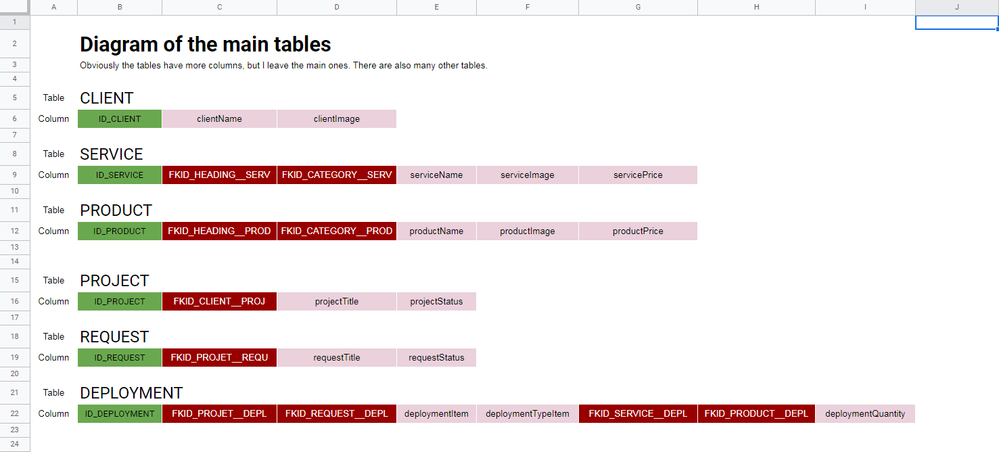

Hello! First of all, this is translated with google translate. I hope you are well and that you understand.
Second. Thanks so much for reading.
I'm stuck with an expression that I can't put together.
The app is for project management and control, with its requirements and the necessary products and services to complete it.
I have many more tables, but I will only name the ones that intervene.
A table "DEPLOYMENT" that contains all the necessary things for each "REQUIREMENT" of all the "PROJECTS".
In this table ("DEPLOYMENT"), many times, products or services with different quantities are repeated.
Create some sample data:
What I want to do and I can't do is:
Obtain a filtered list, where each product or service only appears once, with its added quantities.
Lick to the spreadsheet with the same data as the images.
Thank you very much in advance for any help you can give me.

The easiest way if you are not picky with your display format, then, you can create two virtual columns that concatenate (PROJECT & SERVICE) and (PROJECT & PRODUCT).
You can then configure your views to group on these VC's with GROUP AGGREGATE on [Quantity].
If you want a tabular format, then you need to create tables to extract unique combinations of  (PROJECT & SERVICE) and (PROJECT & PRODUCT). Then create VCs with SUM(SELECT(here get [Quantity] with Filtered by  (PROJECT & SERVICE) )).

If I understand you correctly, you can try
1) Create two slices for DEPLOYMENT, say, Services and Products
the filter expressions are simply ISNOTBLANK([FKID_SERVICE_DEPL]) and ISNOTBLANK([FKID_PRODUCT_DEPL]) respectively
2) Created two views on the slices with only those columns you want
3) If you want to see both views on one screen, create a dashboard to display both.
Hi TeeSee1, thanks for replying!!
Yes, with that I get the two lists.4.pngBut... I would be missing the complicated part:
Sum the products or services that appear more than once.
5.pngSince only expressions that give a Yes/No result can be used in a segment, it is a bit limiting. 😑
Can you think of any way to do it? I already have my head burned from thinking so much XD 🤔😂
Maybe other community experts can propose better solutions..
In addition to viewing the data in the app, I use it to generate a PDF that I then send to the different providers. So the first option doesn't work for me.
But the second looks very promising. It is clear to me how to get the sum.
But not how to get the tables with the unique combinations.
I would have to do this in Google Sheet and not in AppSheet?
You can write an action, add a new row to another table using values from this row.
In the "Only if the condition is true", set something like
ISBLANK(
 FILTER("report table",
  AND([project] = [_THISROW].[project], [service] = [_THISROW].[service])
 to show the action icon only for the rows whose entries have not been mande in the report table ensuring uniqueness.
I would show the action icon as inline so the entries in the report table can be made quickly.
Hi @TeeSee1!! Excellent! Thanks so much for the help and ideas! Your expression works wonders.
In the end I will end up doing it with a Bot, to make sure that there are no products or services left unloaded. But use the action to bulk load what you already had.
I would have liked to be able to achieve it without having to add new tables (because the app already has a lot hehe) but well it works, and with that I am happy hehe 😊
Again, thank you very much!!! 👍
