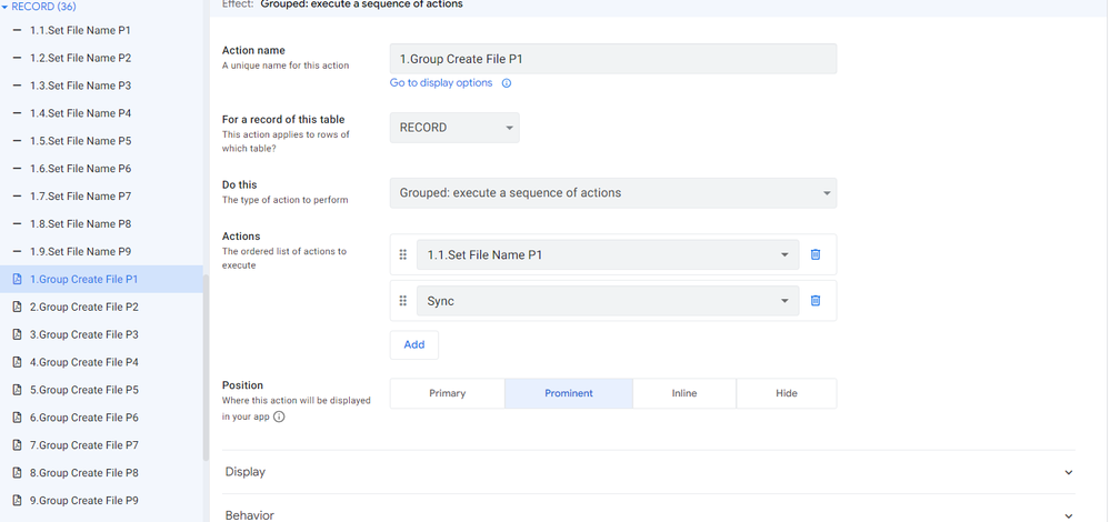

I have 9 print templates, I have created 9 actions and automation bots to print these 9 templates. With 9 actions and automation, will it slow down the app and the pdf file creation process? Do you have any optimal solution for this?
Here is the image of creating action and bot automation
0 4 168
Is 9 templates triggered simultaneously?
This is the trigger condition of the column [_THISROW_BEFORE].[Products_PDF]<>[_THISROW_AFTER].[Products_PDF]
Do you need to trigger all bots ?
No. I just trigger each bot. I have a product column with values โ€‹โ€‹from 1 to 9. if product has value 1 then trigger bot 1 and so on till 9
