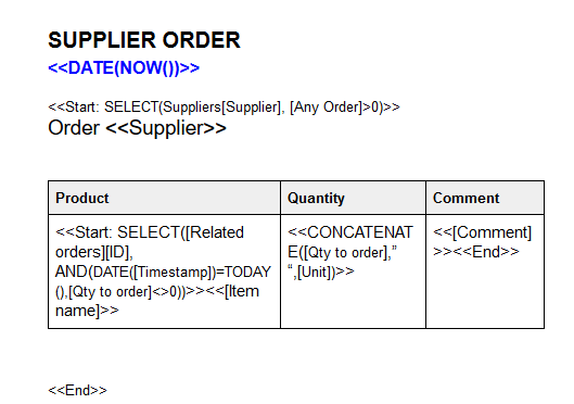

After some times, I managed to get to the result expected, without using โ€œ[_thisrow-1]โ€ as I was not at ease with this Expression.
How I get to the solution: I added 1 column in the Suppliers table where a marker appear when an Order is associated to it. Then I wrote the โ€˜Email Body Templateโ€™ this way:
(the โ€œMarkerโ€ I talked about above is the โ€˜Any Orderโ€™ column).
And here the result:
Hopefully it can be useful for someone else.
