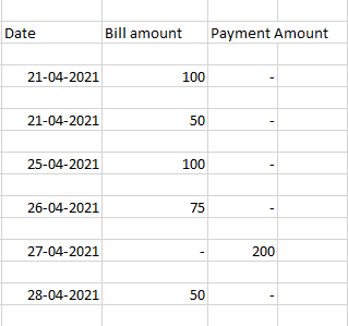

Based on the data I just used as an example, this would be the format of the third table. I have actions in both bill and payment table to add rows to this third table in the required format. But they are actions and forget it once and the whole thing fails
And how do you want the Report to look?
Like this:
So just a list of all payments and bills, sorted by date?
Yes, but I need it in a table-like format like shown
