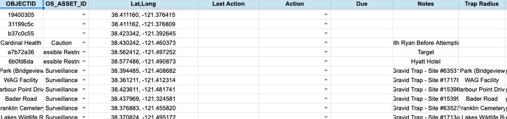

Finally got around to trying this again…
So…I set one table up that will populate with items that have lat, long…
My other table is the master database.
When the second table gets a new item added, I want to be able to bring up every item from the first table that is within a half-mile…
Would you mind taking another look at this? I would use this feature almost daily if I could get it to work.
Hopefully my goal makes sense. Thanks a lot for the help!

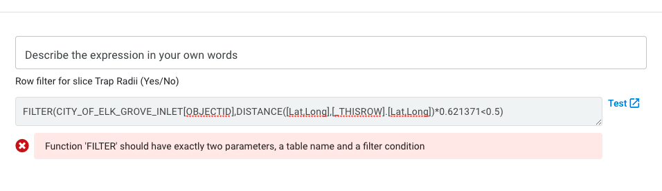

When I pasted that expression in and changed the table name from Master_database to the table I need, it shows up as an error:
Any ideas on that issue?

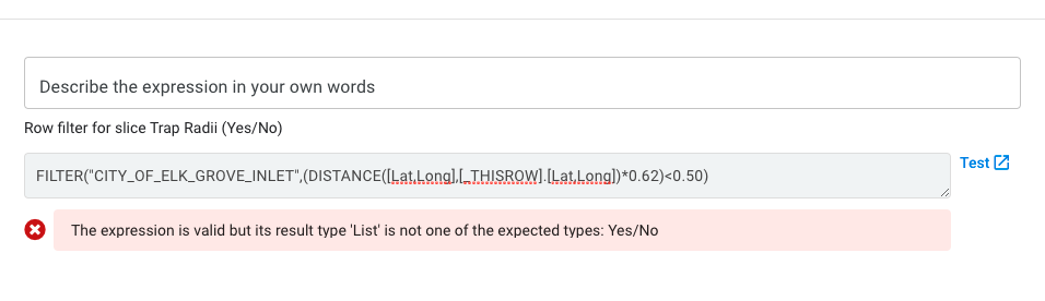

Hmm, maybe it’s the decimals, can you try playing a bit with them? i suspect it’s the decimal digits or maybe the decimal separator, or maybe try this one instead:
FILTER("CITY_OF_ELK_GROVE_INLET",(DISTANCE([Lat,Long],[_THISROW].[Lat.Long])*0.62)<0.50)
This seems like it’s getting closer?
Hold on, you’re using that expression as a slice condition? I thought we’re gonna use it as a valid_if() condition.
I was trying to do that…Probably do to my lack of understanding.
If I set this up as a view instead of a slice, that may help?

One last attempt to explain my system…I have lots of items in my main table (OBJECTID.) Some of those items also have another column filled out (Trap Radius.) I am trying to get a map view where all the OBJECTIDs within a half-mile of the OBJECTIDs with a “Trap Radius” item will show up…
Seriously, thanks for the help. If you have any other thoughts, or if I need to set up my tables differently, please let me know!

The first argument of FILTER() should be a table name only, not a table-column reference. Hence this error:
Replace FILTER with SELECT to correct the expression, or remove the column refernce in the first argument.
