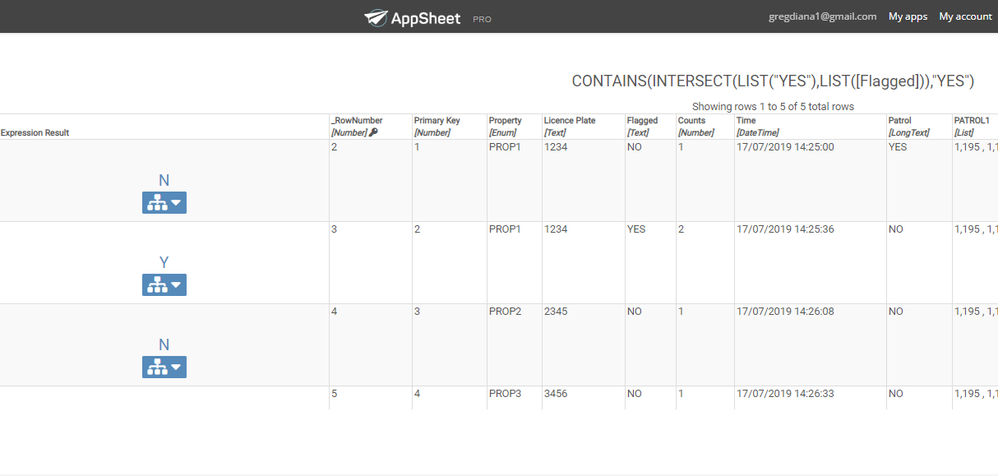

I quickly tested this and this is what I got
This is just to illustrate why seemingly simple expressions and logic do not function as one would expect.

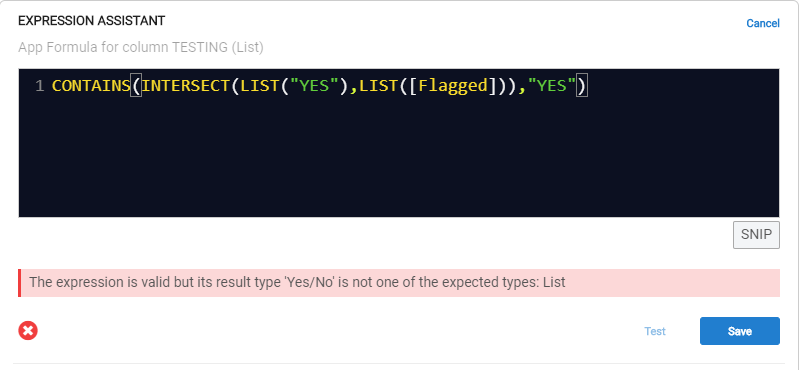

It appears to work but note that in the CONTAIN I had to make each variable of type LIST.
Thus the above would then become
OR(
ISBLANK([Signature]),
AND(ISNOTBLANK([Signature]),
CONTAINS(LIST(INTERSECT(LIST(“YES”)),LIST(Employees[Administrator]),“YES”)
Note that APPSHEET requires incremental debugging of expressions as return values may change so one has to save an incorrect expression to reflect the correct type and then it works.

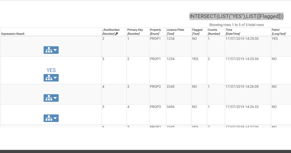

INTERSECT(LIST(“YES”),LIST([Flagged]))
Returns
Which is correct as it only identifies rows in column Flagged that are YES and all other are blank.
But it is of type LIST and you require BOOLEAN
Now if you add CONTAIN it gives error as it requires type YES/NO

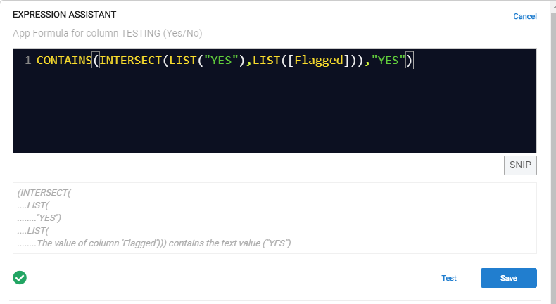

Now save and change to Type Y/N and you get
and the result is
Which is what you wanted and which return a BOOLEAN for each row with YES.

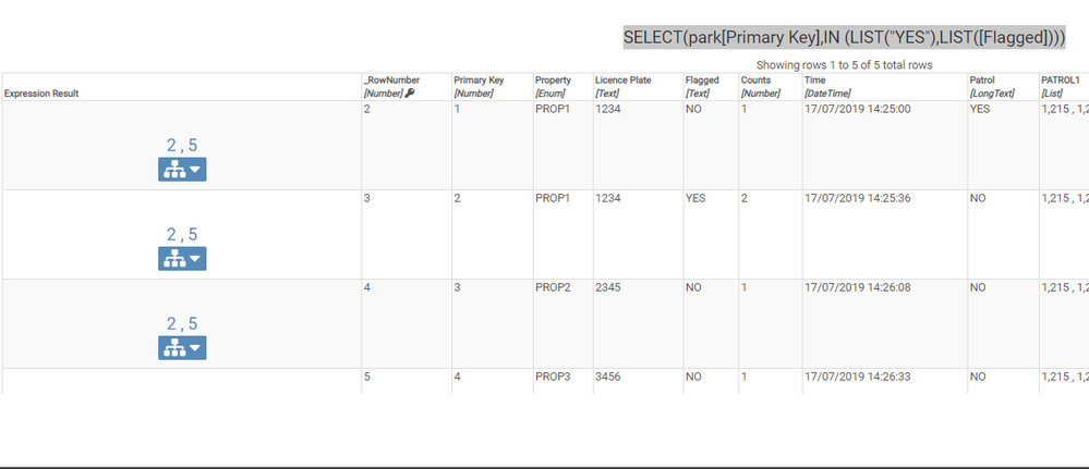

Now if I add a SELECT it returns just the rows with YES
SELECT (park[Primary Key],CONTAINS(INTERSECT(LIST(“YES”),LIST([Flagged])),“YES”))
You get the same result using SELECT(park[Primary Key],IN (LIST(“YES”),LIST([Flagged])))
