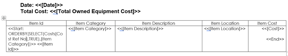

I have a workflow to create a Costs Report
Workflow is based on Total Costs so Total Costs will show at top and then details below.
Item Id Category, Description, Cost Type, Cost
I recently changed the structure of the Costs table. Previously the key was Item Id. I had to change this to add a Costs Ref No as an Item may have multiple costs - Purchase, repair, service costs
The workflow worked before but not know with the new key
I have a VC in Costs called Category to pull the Category in from the Equipment table
This no longer works with the Key change and therefore the report cannot find Category

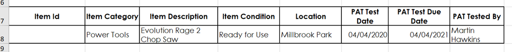

Output is as below with usersettings entered as Millbrook Park
I donโ€™t know how to filter the table by UserSettings and the Item ID is missing when there is more than 1 record in the PAT Check table. It does pick up the latest PAT Test date info but I donโ€™t know why the Item Id is missing.
I got the Filter working
Still canโ€™t figure out the missing Item Id though
Item Id seems to be missing for 1st record in table
Above is when ACC001 and ACC002 have Location = Millbrook Park
Below is when only AC0002 has Location - Millbrook Park
Please test what happens if you remove everything between Row#1โ€ฆRow#6
did that and got same results
I had a missing >> but made no difference.
Removed TRUE, no difference.
Tried [Item ID].[Item ID], no difference
<<Start: SELECT(PAT Test Due[PAT Check Ref No],([Item Id].[Current Location]=Usersettings(โ€œJob Nameโ€)),TRUE)>> <<[Item ID]>>
