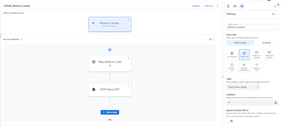

Crystyano_0-1693218881689.png "Everything" starts here, where I have this form from 'Itens_Saida_Filter', where the user can insert these data. After to save the form, I already have an automation to generate a PDF where the trigger is to save a new record, like the image below:
