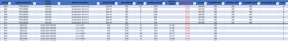

I’m a total beginner with appsheet and just helping out with the app we use at work.
We have a spreadsheet of materials from a few suppliers with their own supplier part numbers.
We use the supplier part number as a reference number to pull up the material specs. however one of our suppliers changed their part number last year and so we now have two sets of part numbers.
I want to keep the old part numbers for our database of previous built products
But when a new product is being built, i only want the new part numbers to be selectable in the drop down list.
As you can see below i have put a column on the end labelled “Current” and have gone done with ‘Y’ or a ‘N’
I’m just struggling to get an expression to work in the validity section
Any Ideas or a work around?

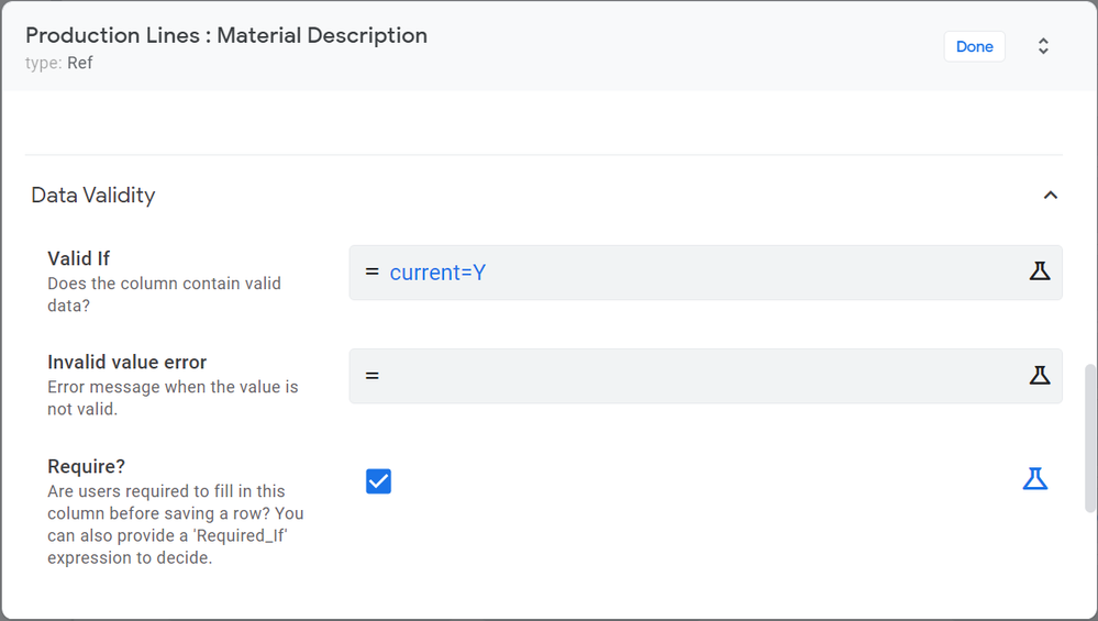

What is the current expression (if any)?
I was trying
[current]=Y
But don’t think it will look within the table to find the column labelled “current”
Where did you try using the expression?
In the column valid if box
but it just says entry invalid whatever you put in now - even it is the correct new part number…
You’ll need to use a slice to produce a list of rows that excludes the old part numbers, then display that slice to your users rather than the table. The Valid if setting is not what you should be using.

Hi Steve,
Apologies - what you suggested worked perfectly! Thanks you!
