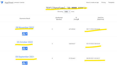

As an example if your UK all locale app has a date of 8 November 2022 captured in app back end in a table as 08/11/2022 in a column called say [DateTime], then an expression of
TEXT( [DateTime], "DD MMMM YYYY") will return properly as 8 November 2022 ( Test screenshot below for various dates where conversion in proper)

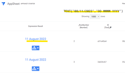

However if you try to code the expression with hardcoded date 08/11/2022 in the same app with UK date format, the expression will take the hardcoded date as US date format, Example screenshot below. So 08/11/2022 gets converted to 11 August 2022
TEXT("08/11/2022","DD MMMM YYYY")

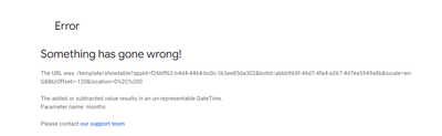

The other use case where I have been having a problem is with my Automation settings on another app.
I have a daily scheduled bot looking for the following filter condition
today()=EOMONTH([Agreement],-6)
This is giving me the following error. As mentioned before all my settings are to the UK. Sheet, Appsheet Table and Chrome Browser. Column Agreement is also in UK format. We managed to get the automation to work by changing it to the US format, but this is not a solution for the customer as they do not work with US date formats.
Your expression today()=EOMONTH([Agreement],-6) seems problematic as it is trying to assign today() which is a function itself to EOMONTH which is also a function. Both function return based on what you parse and cannot be assigned.
