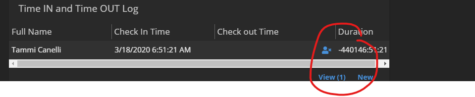

Here are some screen shots - i know i’m not explaining it well.
first step - check in
Then when checked in is not blank (this is the recent row ref) but checkout IS blank I want the action button to go away.
Then to checkout they access their record and click the button with the x.
now we have both checked in and checked out complete and neither are blank I need the original check in button to show again.
Just FYI - the check in button (blue head with checkmark) is the personnel table - the checked in and checked out column in that view are virtual columns for recent row ref.
The blue head with x for check out is in the time log table.
