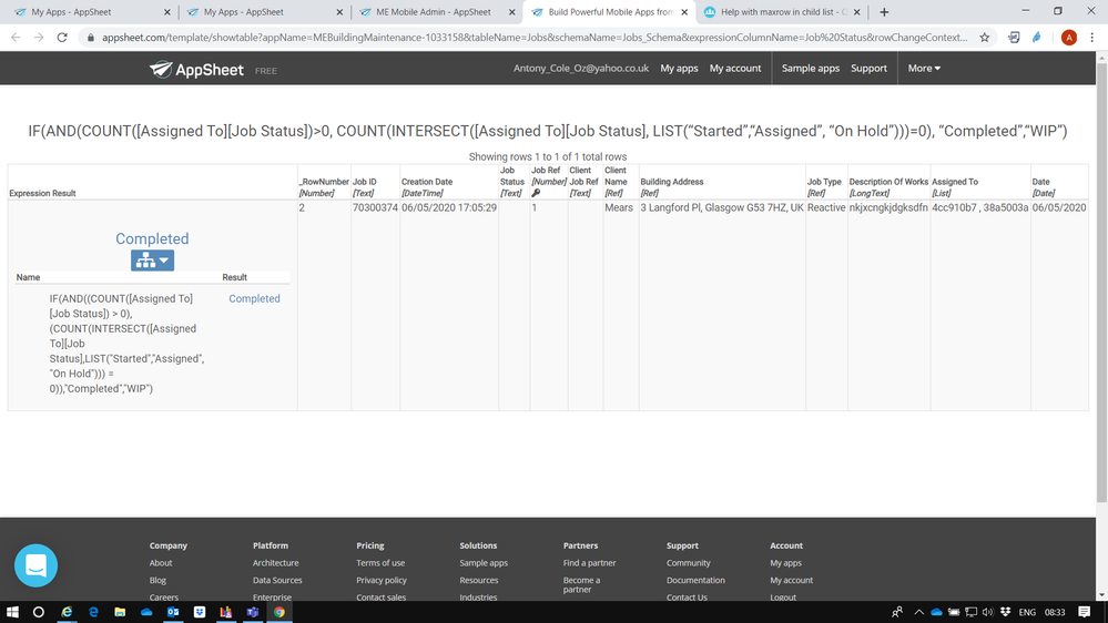

It still shows nothing. when I test the expression the result says “Completed”. But nothing shows in the [Job Status] Column? Column is set to text, and formula entered in the formula box?
Thank you. Is it possible that you can share a screenshot of the test pageof the editor and the column settings of the parent table?
Thank you. Are you able to expand the test expression in theabove screen, by tapping the icon below “completed”
Thank you. Is it possible that you use slighly different name for the [Job Status] column in the child table , say [Job StatusAJ] and use that in the above expression and test it ?
Also can you please make the [Job Status] column in the parent a VC and test?

Looks like this has worked with VC column
Hi @AntonyCole1979,
Good to know that. I believe it willwork with even realcolumn. For it to get working with real column , you will need to “open” or"edit" all existing parent table records and resave thos. This is so becausewith real columns the changes in expressions take effect after opening and closing the recprd again.
