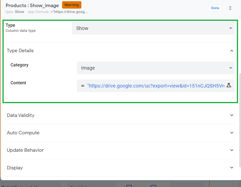

Please try as below
Thank you. And do I add this as a Show column with Image selected?
I tried this https://drive.google.com/uc?export=view&id=1q40YBeo78mQuzF4iBf-sZKZJ3Jqwq-U4 and got this error.
Arithmetic expression ‘(“https:”/“drive.google.com”)’ has inputs of an invalid type ‘Unknown’
If you are using it in show column please include it in double quoteshttps://drive.google.com/uc?export=view&id=1q40YBeo78mQuzF4iBf-sZKZJ3Jqwq-U4

This is what I meant
It sounds that there is still something incorrect in your column setting. Could you share the screenshot.
Jaros
A few possibilities are
  1. In Google drive the sharabale setting for the file is NOT set to “Anyone on the internet with this link can view” Please set it accordingly.
  2. There is some issue in file ID, missing double quotes on the other side of the expression or some space while copying the URL
I believe you may need to do some such trouibleshooting. I retested it at my end and it works perfectly.
It took a very long time to show up. I resynched it shows the thumbnail and then after a couple of minutes it loaded.
