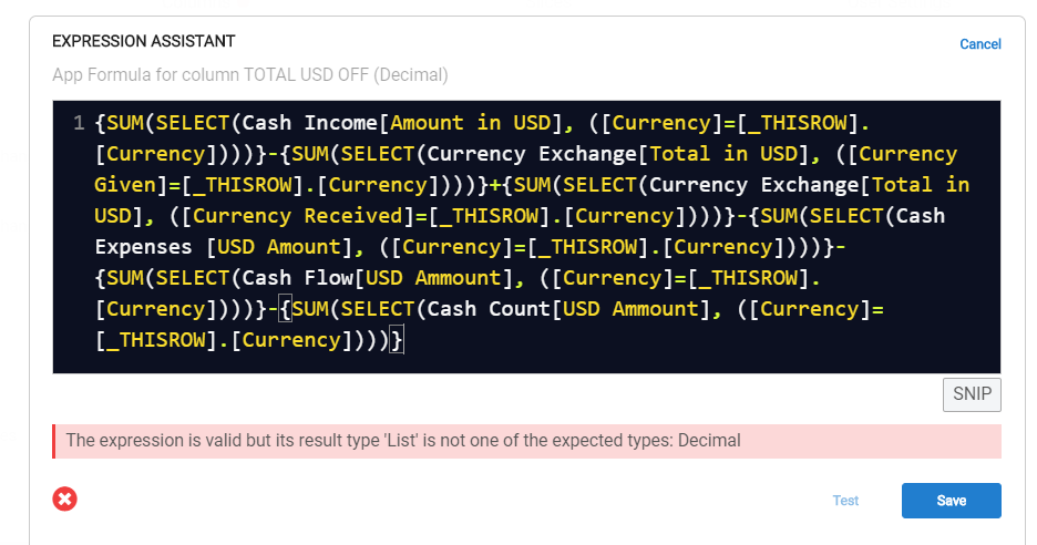

Hello everyone,
I am having a similar issue with an expression, I assume that because of the SELECT as well. I use the following expression a lot in the app and it wors well:
SUM(SELECT(Cash Income[Amount in USD], ([Currency]=[_THISROW].[Currency])))
But I have been trying to create an expression with a bunch of them and it gives me the result as a “LIST” as well.
And this is what it looks like when I set the Type as “LIST” which is not what I want, I want “Decimal”. So there is clearly something on my expression that give sit the “LIST” value but what is it?
THANKS!
Hi @Cabelo,
it sounds that your are trying to add and subtract amounts with several individual SUM statements.
If so, can you please try removing the curly brackets { and } that are wrapped around each SUM expression.
Thanks @Suvrutt_Gurjar

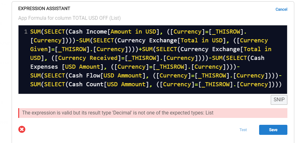

See attachment, still same result!
Hi @Cabelo,
Thank you.
The new error message says, the expression is evaluating to decimal, that you are looking for.
However error says that the expected type is list.Is it possible that your column type is now list type? If so, could you please change it to decimal type?
Oh yeah!!!
Sorry for the lack of attention here, it really looked like the same message
Thank you! One day I will understand these expressions that well!

Hi @Cabelo ,
You are welcome. Good to know it works.
if I may add, curly brackets are one way of denoting lists. So a list could be denoted in following two ways
LIST( “Neptune”, “Mars”, “Mercury”) or
or simply
{“Neptune”, “Mars”, “Mercury”}
I believe your wrapping those SUM expressions in curly brackets were creating independent lists ( single element) out of those each individual SUM expressions. Hence the suggestion to remove the curly brackets.
You may wish to take a look at the following article, just in case you have not that describes the formation of lists with both the notations.
Hope this helps.
For me the use of the brackets, parentheses and etc is probably the hardest part of these expressions. Thanks for the tip, I appreciate that! Learning everyday!
