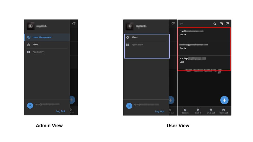

Kindly take a look at the attached image to further understand my question.
I’m able to remove the “Users Management” from the menu bar for the user view (highlighted in blue) but I can’t seem to hide the Ref view from the user (highlighted in red). The view that is highlighted in red are meant only for admins but currently, all account can see it.
How is the user getting to that view?
Actually, I’m as confused as you too. Upon launching the application, this is the starting page for the users while it shouldn’t be. They couldn’t get out of this page, but they still can hit on all the buttons. However, after every action they do, they will eventually land back on this page.
