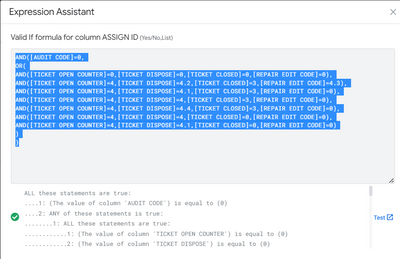

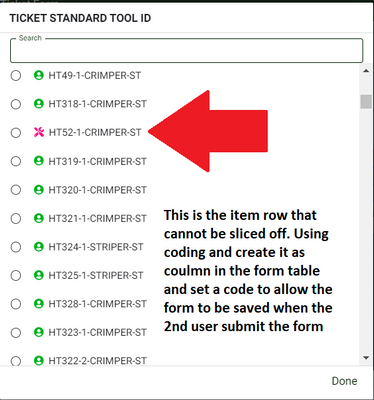

2. Because the form has 2 users the part of the form that need to be signed off cannot be sliced off and required to be remained as visual in the Ticket List slice. So I this create conditions within the form by create sub table outside the form table and create virtual column. Create a coding condition to allow the form to be edited to save the form again when the second user submit. See the dropdown below :
Green logo mean the row which is available to submit to create a new row. A red spanner logo mean the row already exist and the second user will edit by sign off this form and save again
