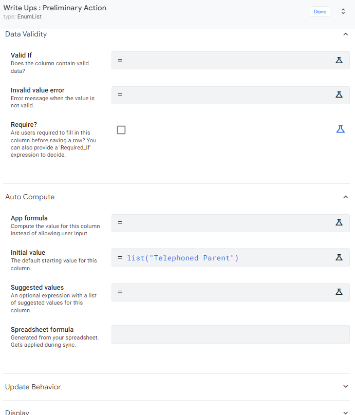

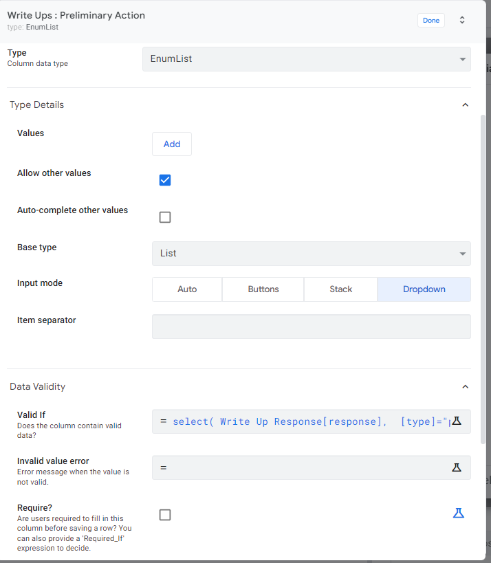

So I have an enumlist that the user selects with a dropdown. I have a validif function to limit their selections.
In the initial value I wanted to use a query function to build my initial values. That didnโ€™t work, so I tested by hard coding the initial value to see if that fixes it. When I run โ€œTestโ€ I can see the response for every row is correct, but when I look at the dropdown it doesnโ€™t seem to highlight the initial value. Any ideas?

Part of the issue here is that youโ€™re not showing us what youโ€™re doing (screenshots!).
Yep, tried with list function. No luck there.
Here are some screen shots
Thatโ€™s your problem I imagine.

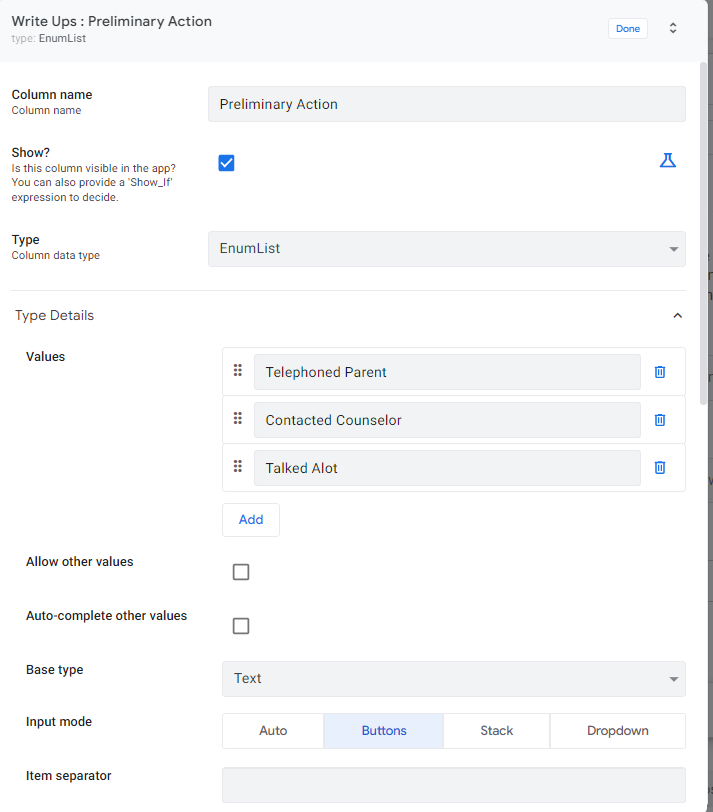

Negatron Megatron. I changed it to Text, no change in the app. Should it be something other than text?
Welp, I found the issue. I had a formula in there to allow for editable, and that stopped it from working. Hmmโ€ฆ now I guess I need to figure out how to make that condition work, and still pre-fill the selection

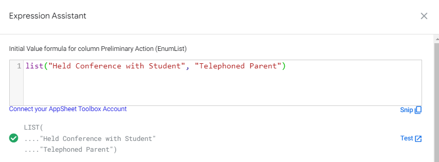

Nope I lied, it worked, then it didnโ€™t work. I erased everything and I just tried to hard code in to see results. See pictures.
Iโ€™m at a loss

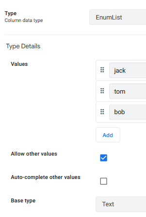

Iโ€™m not sure why youโ€™re having so much trouble either. The setup should be pretty simple. Here it is working on my end.
Then when adding a new record:
