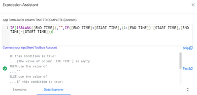

I try putting  ```IF(ISBLANK([END TIME]),"",IF([END TIME]<[START TIME],(1+[END TIME])-[START TIME],[END TIME]-[START TIME]))```  in to the formula section but it doesn't work. This formula works in spreadsheets, but not on the scope of the app level.
I think it's because the time input only does "AM / PM" formatting, so its numbering format doesn't fit the formula validation parameters and I don't quite know how to compensate for it yet.
