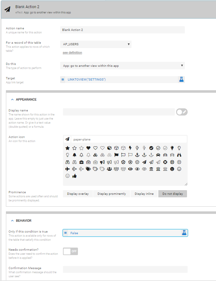

Create this action

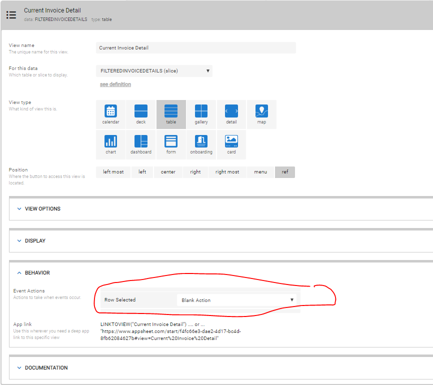

Go to your table view and set the row selected action to be Blank Action 2
When you click the row it will try to execute Blank Action 2 but since the behavior is set to false it will not take the user to the settings view.
