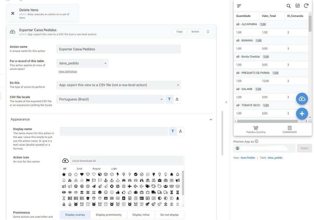

Hello Joseph,
I am facing the same problem but the proposed solution does not work.

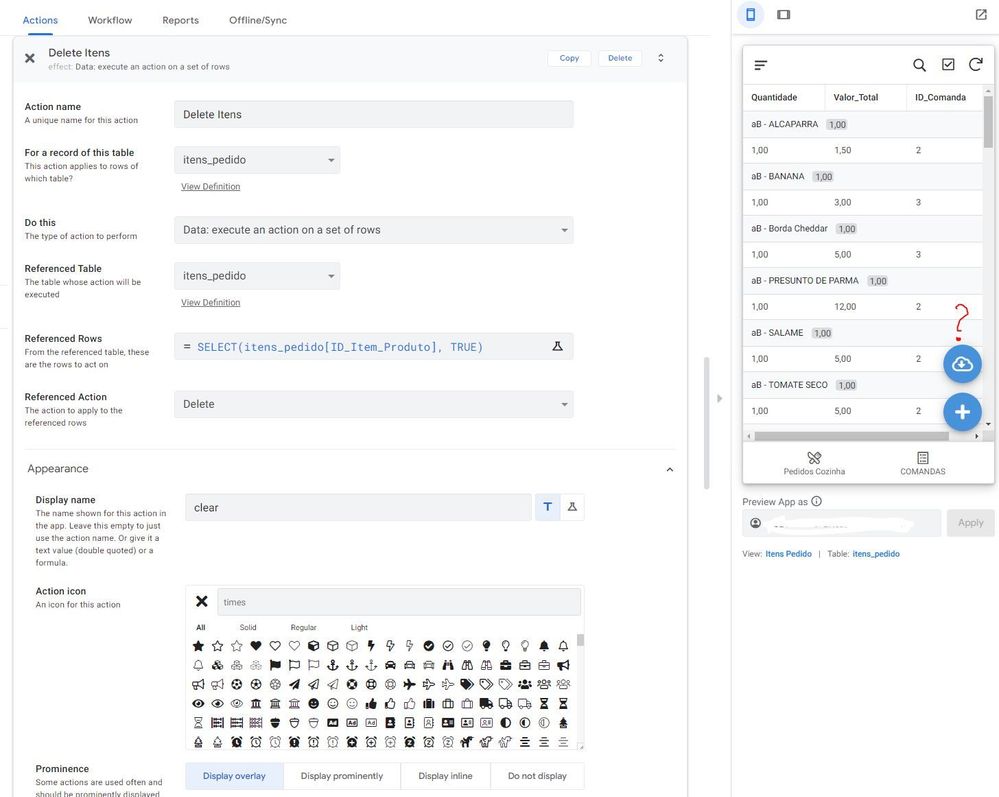

I put a button to export and it works fine, but when I put a button to delete it doesn't appear. I send the image to better understand.
The delete button should appear above the export button
delete button doesn't appear.delete button doesn't appear.button to export  appears and works finebutton to export appears and works fine
The delete and similar actions operate on a specific row or a set of rows. When in a table view, your action does not show because AppSheet wouldn't know on which rows this action would be executed.
If for example you use the selection button on the top right, and select one or more rows, the action will be enabled and upon clicking it, it will execute on the selected rows.
Ok.. I understood
But Is there any way to create a delete all button on this screen?
