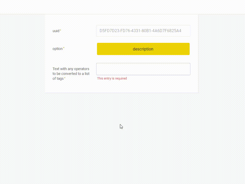

@Steve, I made a GIF animation:
Thank you for the GIF. I have no explanation for the behavior youโ€™re experiencingโ€“Iโ€™d expect it to work. So Iโ€™d call this a bug (or I donโ€™t fully understand how hashtags are defined by AppSheet). Please contact Support for help with this, and let us know what you find out, please!

Thank you. AppSheetโ€™s EXTRACTHASHTAGS() function extracts hashtagged words from a text. At least from the GIF you have shared, it appears that you are doing a reverse process. You are entering some words and in turn the upper field attaches hashtags to those fields and in some fields that process does not work.
Could you elaborate, just for our understanding, ? Maybe I am missing some point.
@Suvrutt_Gurjar,yes of course, here are the details of my process.

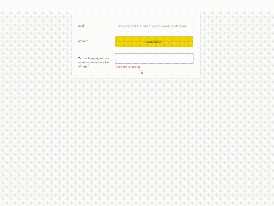

I take the Longtext field and write any text content in it with the insertion of specific operators like {any_operator_1}. Next, I need to extract these operators into a separate list, so that I can then compare them with the database of available operators. With the example in GIF, I showed only a โ€œpieceโ€ of this process.
The fact is that the user can make a mistake, this is a kind of validation within a specific process.
Below I show how it works with a regular hashtag insertion:
