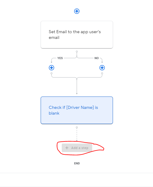

If I have a return values as the last step in my process it blanks out add a step? Makes it extremely annoying that I have to add 2 steps then set the first one to be return value. Also how does return a value differ from just looking up the values in my next steps?

RETURN value step. In the programming, it means one particular function to return the value. If there is any subsequent steps, they will not executed, as return is sign of the end of process.
If we ended up steps with return step, then we need to move to another step, thats why I feel Appsheet is graying out the following step so that we are not allowed to add any more steps as it wont be processed. This was what I thought.
then as you rightly said, it is troublesome and painful we start to build up the separete process.

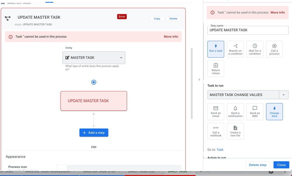

Ok I’m doing my best to understand and feeling quite dumb for not being able to do this. If you’re willing here are some screen shots of what I’m doing so far.
This is the first part of your process, when a daily task record is changed it triggers the process called “PROCESS DAILY TASK” which calls another process called UPDATE MASTER TASK (the parent) The ID for the MASTER TASK record is the ref column from the Child DAILY TASK record.
And here is the next part. In the expression boxes next to the MASTER TASK fields I only have fields corresponding to that table? How can I use the values from the DAILY TASK table then?

Hi @Ethan_U ,
If I understand correctly you have a parent process that takes a daily task and you want to update the corresponding master task with some data of the daily task.
Maybe this trick will help, if you noticed the call process step allows you to lookup a row from the [MASTER TASK] table by an Id. It also allows you to update any of the other fields of that row by clicking the ‘Add’ button and providing an expression. Here you have the context of the DAILY TASK so you can use that.
In the child process you can have other steps you might need to send email/notifications…
Let me know if that helps.
Another option if you dont need to do additional step in the child process is to use the data action task “Add row to another table”. If the row already exists then this action will update it, it does require thought that you provide all the required columns.
