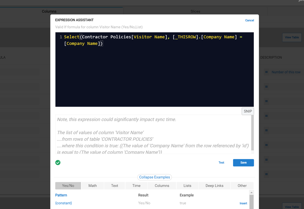

Fixed.
Select(Contractor Policies[Visitor Name], [_THISROW].[Company Name] = [Company Name])
Changed to This
Select(Contractor Policies[ID], [_THISROW].[Company

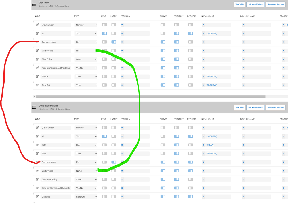

Screenshots of what you’re trying?
Also, I tried to change the label, etc, but cant do multiple
Red to Red,
Green to Green
Ah. A Ref values references the entire row; you can’t “reference” a single column with a Ref value. You can, however, dereference a Ref value to get the column value from the referenced row. You’ve not shared enough information about you data to offer concrete suggestions on how to implement this for theses two tables.

You probably shouldn’t be using Ref for any of those four columns. Instead, use Text or Name type, and use Suggested Values to produce a list of existing values to choose from or add a new value.
So that was that, Now Company name is referanced from the companys table and the Visitor name comes from the Contractor Table,
See Folmula,
Only thing is apparently my referance is broken?
Im trying to Use Referances wherever I can because any name edits, or company name edits changes everything which i Love,and i love the relational lists etc. for Easy Data overview
I don’t think you’ll be able to use Ref values in all four columns here.
its only 2
Well, three:
Regardless, a single row can only have one (textual) label.

3 Tables.
A. Signinout
B. Contractor Policy Table
C. Company Table.
Table A
2 references.
Company References the Company Table
Visitor Name references the Contractor Policy Table
Table B
1 Reference
Company Name References the Companies Table
Table C
No References.
I’m getting a Broken Reference on Table A for Visitor Name.
This Formula
Without This Formula, everything works perfectly. It just shows all the names, but I only want the names related to the selected company to show up when a user signs in or out.
Any Reason Why it works fine without formula but shows broken referance with formula? Is it my formula? Not sure what I should Change.

Fixed.
Changed to This
