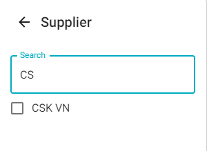

Hi guys,
I'm trying to search filter Ref column by text. 1 works, 1 doesn't work, but both are Ref column
Not sure why
Hope you help explain
1 that not works
1 that works
0 5 405
A Ref type column's values are key (i.e., not label) values from the referenced table--even though the displayed values are the referenced table's label (i.e., not key) values. If your Suppliers table's key column is also it's label column but that's not the case for your Styles table, then that's likely the explanation.
Thank you but what confuses me is my supplier table key is UNIQUEID() column
It's the same with the Style table, but why I can filter Supplier by certain text but not with the Style
The [Supplier] column in your screenshot is populated with the values from the [Supplier] column in the table referenced by the [Material] column (per the App formula expression); it's these values that the search/filter function is based on. If those values are not also key values in the Company table's key column, then the [Supplier] column in your screenshot is not configured appropriately to serve as a reference to the Company table.
But in Material table, Supplier column is also Ref type to Company table
Sorry if I don't understand you, but are there any work around or method to search The Style column ? Create a Virtual Text of the Style column to search ?
