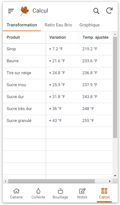

I'm building an app for my personnal sugar shack needs. I have a tabbed view here showing degrees I need to boil sap to, to create different products. (Sorry for the french app version!)
Basically, the initial value is 212F (hidden) + variation = Adjusted temperature
Question is:
I want to be able to change the initial 212F in the calculation of each line within the app via a simple button. I would like this to be more of a calculator than simple table.
Is there a way to achieve this?

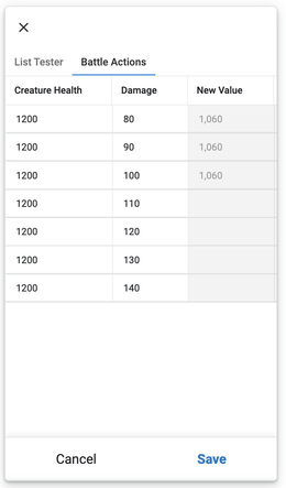

1)  Table views do have a QuickEdit option you can turn on to make the table editable.  Below is an example Dashboard.
2)  You can use Inline Actions as buttons on the table rows.  For example, you could have 2 buttons - increase and decrease - on each row.
Example Dashboard view - QuickEdit button highlighted
Example of Table in Edit Mode - Gray column is not Editable

Just so it makes more sense to you, the Initial Value actually is the boiling point of water. When boiling sap, you add the "variation" value to the boiling point to make different products out of it, like maple syrup for example.
My goal is for each user to be able to update their Initial Value (boiling point) daily, since it slightly changes everyday according to barometric pressure.
That's why it's something I'd like to have within the view. Since it's not something you set once and never touch it again, it makes more sense to me to be able to update it directly in the view.
