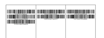

Now the impression was as I needed.
Thanks also to Aurelien
The report was thus
<<START:FILTER(Produtos, IN([_ROWNUMBER], LIST(1,4,7)))>><<[CodigoBarra] >>
<<END>>
<<START:FILTER(Produtos, IN([_ROWNUMBER], LIST(2,5,8)))>><<[CodigoBarra] >>
<<END>>
<<START:FILTER(Produtos, IN([_ROWNUMBER], LIST(3,6,9)))>><<[CodigoBarra] >>
<<END>>

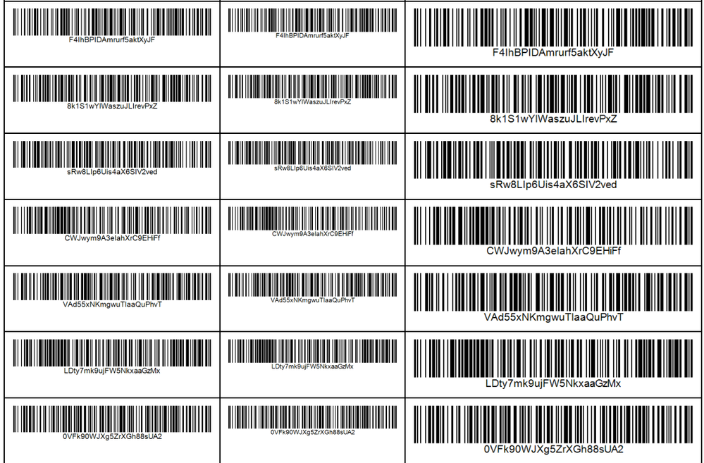

The test results in my test app are shown below.
The report looks like below
The products are arranged in the view as below. So you can see that in the report above, the images are aligned  horizontally as 1, 2 , 3 and then 4, 5, 6 and then 7,8, 9 and then 10

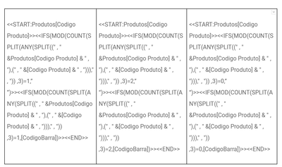

Could you please share your actual template ?
Estimated friend Suvrutt_Gurjar, look at this situation, I got the expected result but it was necessary to include another information in the case " ", has any explanation for this fact?
In the template it was placed like this
And the result presented is this

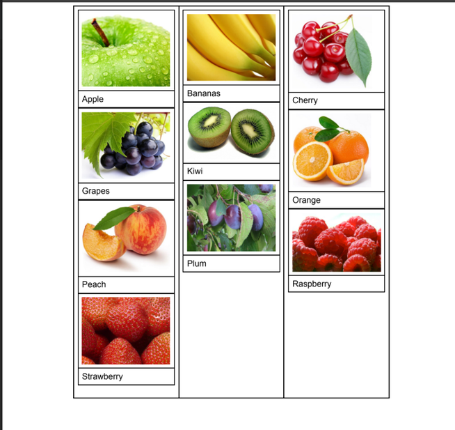

The report looks like below. We could make it a bit more elegant by removing those intermittent table borders but still the vertically placed images mismatch in height due to their different image heights.
The report produced looks something like below.
The template is given below. It is for a Products table with [Product Name] and product [Image] columns. [Product ID] is the key.
<< START: SELECT(Products[Product ID], MOD(COUNT(SPLIT(ANY(SPLIT((" , " & Products[Product ID] & " , "),(" , " &[Product ID] & " , ")))," , ")) , 3)=1)>>
<<[Image]>>
<<[Product Name]>>
<<END>>
<< START: SELECT(Products[Product ID], MOD(COUNT(SPLIT(ANY(SPLIT((" , " & Products[Product ID] & " , "),(" , " &[Product ID] & " , ")))," , ")) , 3)=2)>>
<<[Image]>>
<<[Product Name]>>
<<END>>
<< START: SELECT(Products[Product ID], MOD(COUNT(SPLIT(ANY(SPLIT((" , " & Products[Product ID] & " , "),(" , " &[Product ID] & " , ")))," , ")) , 3)=0)>>
<<[Image]>>
<<[Product Name]>>
<<END>>
