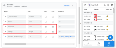

Using the AppSheet Workout Log app template found here, the "Workout Log" table has a column "Exercise" that references a column in the "Exercises" table with the same name.  That Workbook Log table's Exercise column is set as the table's key, as shown below.  I want to make that column editable and key columns cannot be edited per documentation.
Before changing the table's key:
Per the docs, I've created a separate column in the spreadsheet for "Row ID" and set that as key.  This solution however prevents the images from appearing.
After setting the new "Row ID" column as key:
Is there a workaround to have the referenced "Exercise" column displayed correctly AND use another column as that table's key?

Thanks for the reply and samples.  I got in touch with AppSheet support and a person there noticed the problem is with the template's Image column-type.  It is set as image-type when it should have been set as thumbnail-type when the app was created, according to the person.
He said that the problem was that the linked images' resolutions were too high for, I suppose, the table view-type.  Images he estimated should be no more than 200px (which is the dimension of all my linked images, for what it's worth) .
We tried several ways to try to convert the column-type (e.g. new tables, deleting and reconnecting that database, etc.) and he concluded that there's no workaround to convert the values except to (1) change the source column's column-type via the AppSheet editor and then (2) manually edit each entry via the app so that their labels match the correct image.
Though these steps worked, there may be (should be?) another way to short-circuit that process.  This process also changes the database (Google Sheets) entries under the "Exercise" column of the "Workbook Log" table to random alphanum characters (even though the it's the column-type under the Image column that was changed).  Other drawback are relatively minor.
