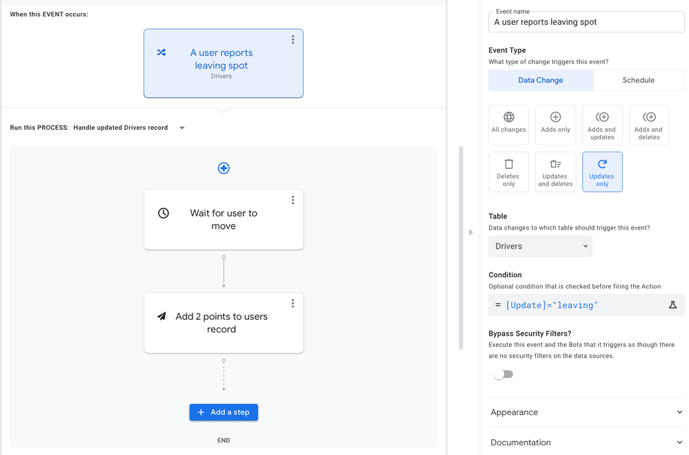

hmn, what if i create an automation to wait for location to change as such found in this snapshot
A wait step still needs to be triggered by some data change.
can a column that is a 2 minute timer referencing another be used as a trigger to the check if location changed?
Screen Shot 2022-04-21 at 5.12.30 PM.pngthis should trigger the wait
Honestly my best advice here is to just drop this. Appsheet is not suitable for real-time location tracking. Sure, you may be able to configure a work around that's good enough for your exact situation, but you haven't shared what your exact requirements are, so it's impossible to say.

As for the screenshot of your Bot, without sharing the rest of its details, I have no way to comment about that.
I agree: AppSheet is not suited for this.
