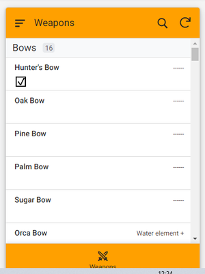

I'm trying to make a app so I can check the items I already got on a game.
I've already managed to get this done.
What I'm trying to do now is add a checkbox under the Item name, on the Secondary header section. And create an action to mark completed/not completed on it. Like on the image bellow.
Is there a way to achieve this? Or any advice on how to do this with a similar or better layout?

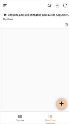

Maybe you are looking for bulk actions? AppSheet allows the user to select multiple rows ( or a single row as well) using bulk actions option in summary views( table, deck , gallery etc.) . After selecting the row(s) you can apply the action. In this case you need not go to the detail view.
Use bulk actions - AppSheet Help
Also the below GIF shows, one can change the status with bulk actions in the deck view itself.

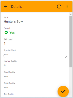

This screen shows the details for the item. Here, the green icon isn't clickable. But there is the huge button at the bottom that executes the same action, changing the icon to Green or Red.
You can choose colomns to show in details view(in UX section/column order) ,
and also choose actions you needed using slice
