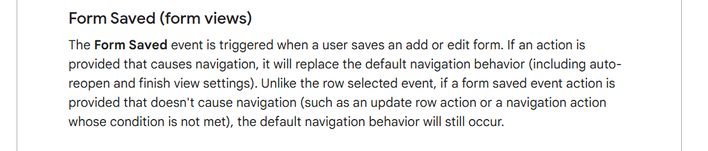

You need to include the action in the "Event Actions" Setting of the form view as the example screenshot shows below.
Many thanks! This is so great to see the Action can triggered successfully after changing the Form Saved in the form views!
For those who might have the same issues as me, it is located in the System Generated under the Views.
