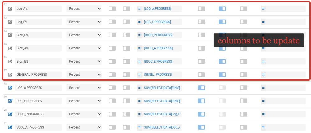

In the end, I didโ€™t figure it out how tot update the records. In app, when I add a new record or when I make an update, specific columns in all records needs an update, to add the correct values to the spreadsheet.
columns to be update
How can I make this work? Could you please guide me to create this workflow.
Thank you in advance.
