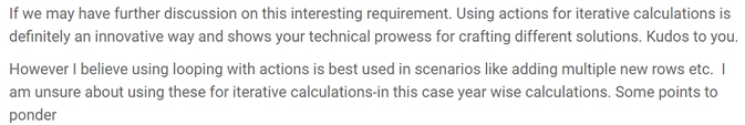

Hi @TeeSee1 ,
If we may have further discussion on this interesting requirement. Using actions for iterative calculations is definitely an innovative way and shows your technical prowess for crafting different solutions. Kudos to you.
However I believe using looping with actions is best used in scenarios like adding multiple new rows etc.  I am unsure about using these for iterative calculations-in this case year wise calculations. Some points to ponder
1. Each change in start or end date will need invoking of at least 4  actions + 1 action for each  year. If the user quickly checks  10 different cases, around 50 actions could pile up. Of course they will execute in background but there could be too many actions involved in general on a daily basis.
2. There will need to be a direct ( such as tapping on group action icon button) or indirect way ( form save event)  to invoke actions after the user changes the dates. So there are additional user interactions.
3. If dynamic calculation of penalties with respect to TODAY() is required, it will not happen on its own for multiple records.
With the pure expression method
1. If the expression is in a VC , the changed penalty ( it it is calculated with respect to TODAY()) will auto reflect daily for all applicable records.
2. Even if the user checks 100's of different start /end date combinations in a form , the penalties will immediately calculate without even saving the form- something like a calculator.
May be I missed some point in actions method. Please feel free to add your thoughts.
