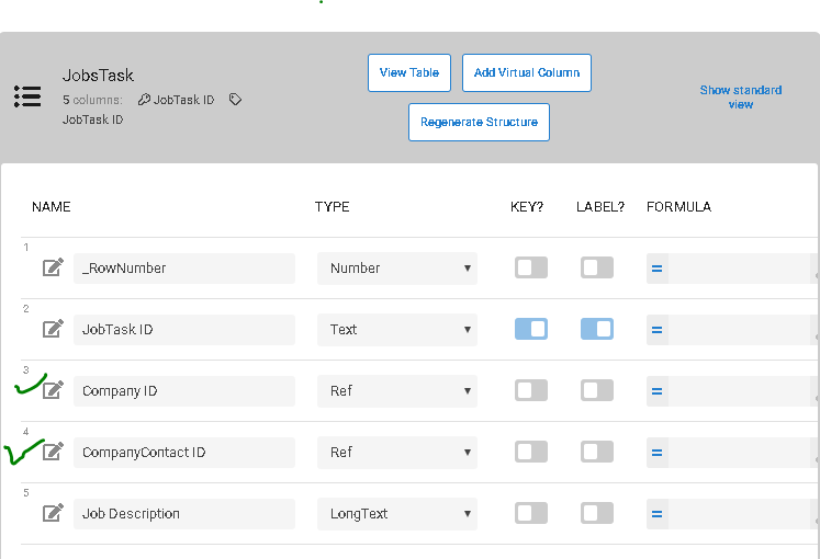

Hi Paul
Thank you for all the details.I appreciate.
Is it correct understanding that Company ID ( referencing Company table) and CompanyContact ID ( referencing CompanyContact table) are Reference type columns in the JobTask table?
Also Company ID (referencing Company ID) is a Reference column in CompanyContacts table?
The above is from a quickly stitched test app.
Hi Suvrutt,

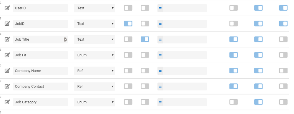

Yes, you are correct. Here is my screenshot of the Jobs table.
Company references Company Table
Company Contact references CompanyContacts table.

HiPaul,
Ok, thank you. In the meantime , based on your earlier posts and picture shared , I suggest you toplease try the expression mentioned below.
I believe your Valid_if expression of column Company Contacts in Jobs table should contain following
SELECT(CompanyContacts[Key column Name of CompanyContacts], [Column name in CompanyContacts table that references Company Table]=[_THISROW].[Company Name])
Please replace thw column names ofhighlighted text with actual column names you have.
