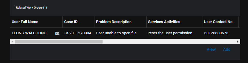

my related reference view is displaying another ref view. i wan it to display the table inline ref view. anyway we can decide/change the desired ref view?

Youโ€™ll need to create a slice on the table, reconfigure the column containing the list of Ref values to refer to the slice rather than the table, then attach a desired inline view to the slice.
Thanks @Steve works like charm.

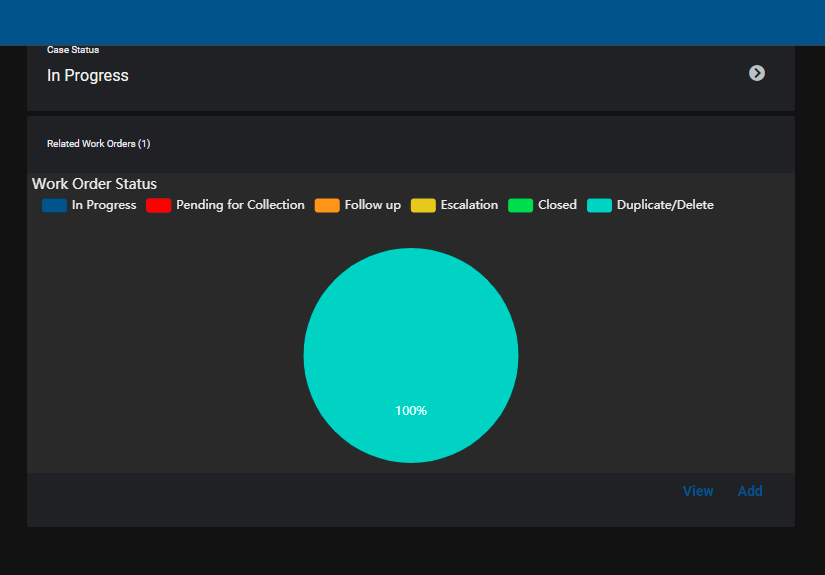

because of this priority * If all else is equal, we choose gallery > chart > map > deck > table > card
i have a chart for the dashboard on the same table, hence it is taking precedence. but i would like to have the related reference, display as details view. do you know any workaround that, we could override the default as mentioned by @praveen
There is no alternative other than what I offered.
