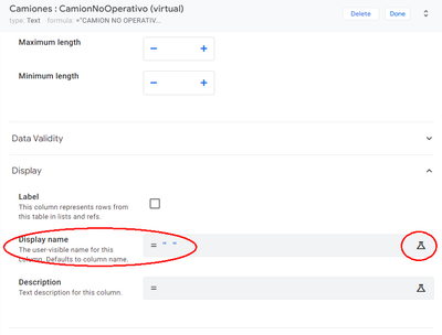

In the column definition (after creating and saving it), in the Display area, there is a Display name section.
You can create an expression with (or whatever you need):
IF(ISBLANK(name_email, "Name", "Name Email")
Hi, no no no
I don't speak about the column "Display Name" section.
I speak about the "Label" checkbox option.

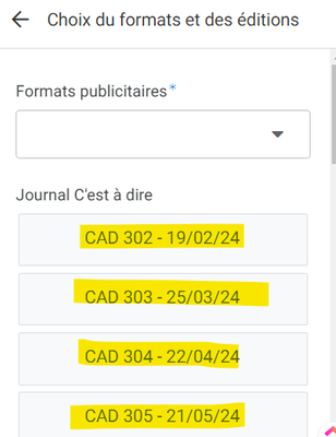

I could sum up my application as a quotation system
I add items to a quote and it calculates the total
I have a list of products that I can select by clicking on buttons (label: product reference + expiry date). The date is very important at this stage
And the products are displayed in the Inline view of the quote. In this view, I'd like the label to display just the product reference (to make it easier to read)
In your case, you would need to have an extra column to read the name value only. And then show it on the inline view instead of name & date.
Thanks @AleksiAlkio , you solved my label problem
I create a virtual column and I use this virtual column in the inline view !

crea una columna virtual que tenga la fรณrmula que quieres concatenar. Y esta debe cambiar de valor segรบn la condiciรณn. Luego la marcas como label.
