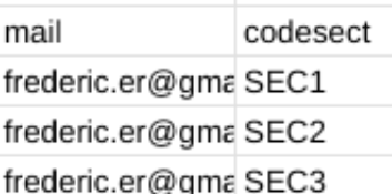

Table 1: Users, on this table I have email addresses next to sector codes
Table 2: 'Sites' I have site names next to sector codes
I can't find a way to display the sites according to the user's email address. I've tried searching the forum but I haven't found my solution.
Thank you in advance, have a good day

That's what I need, however, I have a problem with the result. The formula only displays one matching value.
The problem is that I would like to display all the sites with their different sector codes, but the formula only shows me one matching value. Would it work better if I use the "Any" function?
Thank you for your help.
