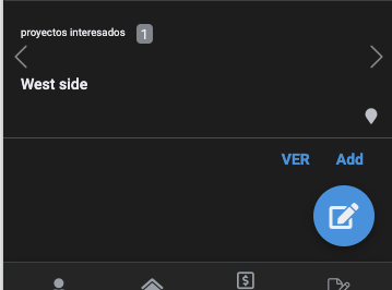

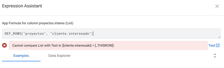

Well I have a table call clientes and another call proyectos with a column name cliente.interesado. This is what I'm getting when I either add a virtual or physical column. cliente.interesado column is the enum list type ref. Am i doing something wrong or missing something? @Steve @SkrOYC @Marc_Dillon

You didn't do what Oscar suggested you to do, which is what you should do.

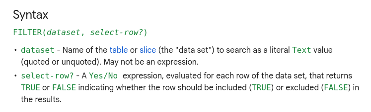

Do a Select() or Filter() witn IN()
@Marc_Dillon I actually have been trying everything you guys have told me without any luck. I believe I'm doing it wrong. I apologize, but I'm not very good at this. ๐Ÿ˜…
But hold on, didn't you say that REF_ROWS is the same with more functionality than Select or filter in this case?

REF_ROWS() estรก pensado para cuando la configuraciรณn es estรกndar, un Ref hacia la tabla parent. De hecho se crean las "Related ..." automรกticamente.
Como estรกs usando un EnumList basetype Ref, REF_ROWS() NO funcionarรก. Debes usar FILTER()/SELECT() y filtrar las filas usando un IN().

FILTER() - AppSheet Help
IN() - AppSheet Help
@SkrOYC I'm using FILTER()/SELECT() without any luck yet. I will keep trying even if i keep failing. I've read all of these documentation you sent me. However still having issues and this is why I ask the community, so it doesn't take me a month to figure it out.

@SkrOYC can you give me an example on how to use and IN() inside of a SELECT()?
First, I'm more inclined to use FILTER() which is the same as using a SELECT() when it's pointing to the key column of the respective table.
Second, some expressions that return a list of values has an argument that is evaluated on each row to decide if a row is going to be considered or not (so the expression should return yes/no), that's the case of FILTER() and SELECT().
Third, IN() return yes if the item (the first argument) is inside the list (the second argument)
