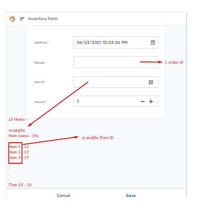

I am designing an inventory management through appsheet.
I need to outbound multiple products for an order.
Currently i need to put in the remark on order ID that need to outbound, then scan the item that need to outbound, 1 by 1, which is not really efficient.
Below image is my current setup and UX.
Could appsheet do multiple outbound for the same order ?

thank you for the reply!
Sorry,
I am new in appsheet.
Currently i have a parent table , which is the full product listing.
My inventory log is ref with this parent table.
You mean i now treat the inventory log as parent table, and make another child table to record the order?
And how can i create multiple scan for a single order? what type to use?
