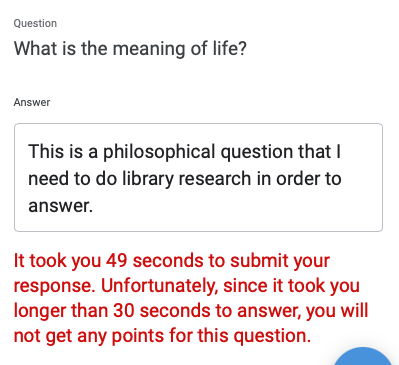

If you look at the sample app I made, it records the time that the student begins to look at a question.  Then, it could record the time that the answer is submitted (though I haven't yet set it up to do that).  Would that be a solution?  I'm not sure what your criteria for a solution might be.
I got interested in the issue and decided to add some functionality to the sample app I made for you.
So, now the countdown looks like this:
Then, when an answer is submitted the countdown disappears and a confirmation message is displayed.
If it took the student more than 30 seconds to answer, the confirmation message looks like this.  Check it out.
