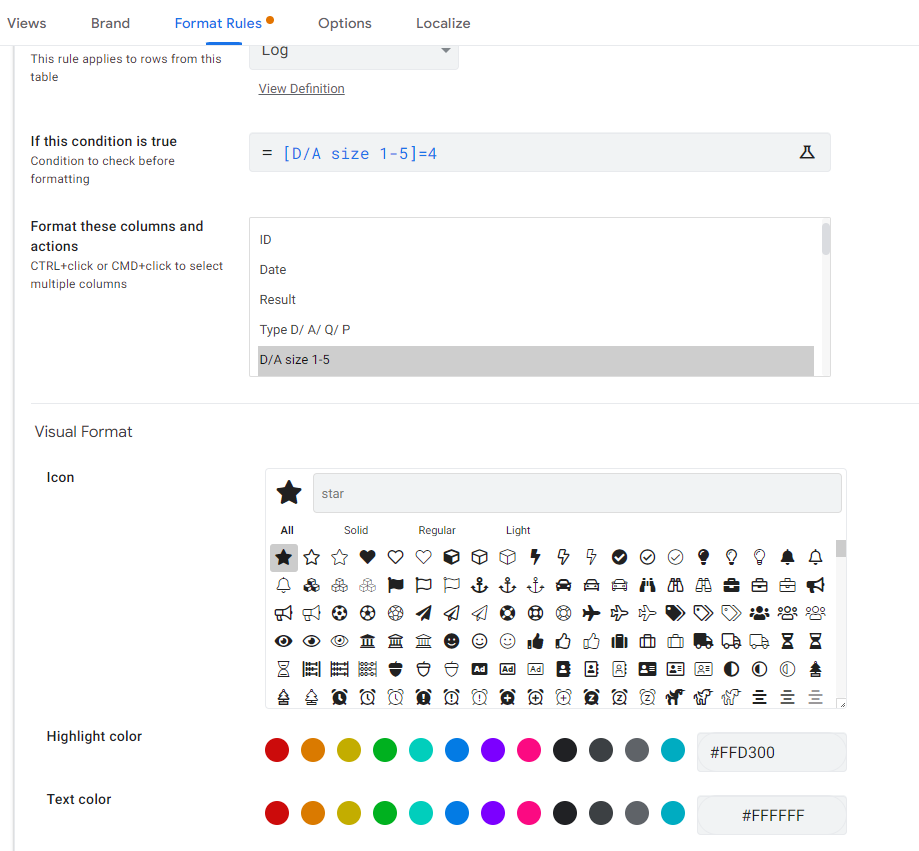

Hi all, I Don’t know why my app just show 1 star only, [D/A size 1-5] type Decima (display name how important It is), I created 5 format rule 1 star to 5 star
Hi @Phong_Lam
I dont believe you can do that using formatting. You could use an enum with star icons copy pasted in.
Hi @Lynn, How can I made It have colors ? I don’t know where I can find the icons to copy so I take the stars above from @Steve , thanks
Hi @Phong_Lam
I didnt read back through the thread, I dont know how you colour those ones.
I wish there were a sample app. At this point, I think one would need to go back to the following to figure it out (Suvrutt has already shared this link):
That’s right, @Suvrutt_Gurjar already shared link. But I did not follow the instructions very well. Now I understood. Basicly we we to have over 10 format rules to get It done
