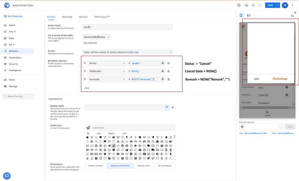

Hello, I try to create INPUT Box
but the result is in this picture below
what’s wrong with it please tell me how to improve that ^^
Thank you

What column type is the column that you’re changing with the INPUT() function?
I saw other video and did like in this picture
That should work.
Check this post there’s a little app using the INPUT() function. I used it to learn how it worked and it was really helpful.
Maybe it will help find what the problem is.

@Nattakarn_Girl is there any visibility condition on the “remark” column (show expression)? I think those could cause columns to be hidden even in this context. If that doesn’t explain it, can you file a support request through this form with the details requested there?
