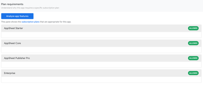

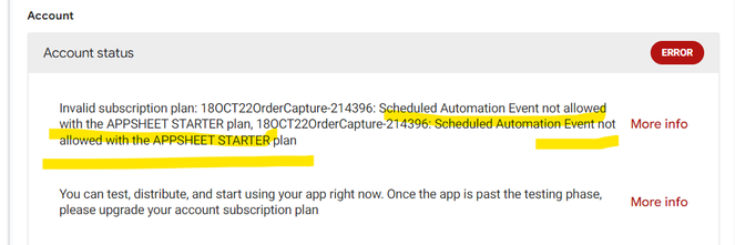

This is so helpful, thank you very much! Weirdly enough the Deployment Check contradicts what I see under "App Info" - if I understand it correctly.
Analyze App Features:
Deployment Check:

Okay. Thank you for the update. I think you may want to contact AppSheet support or sales in this case.
